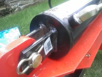

here are the pics of the speeco..... my guess is its 4 1/2 inch cyclinder it has 1/2 and 3/4 inch lines on it

Odd that they put the filter on the intake rather than return line.
is this the first one you have seen?
is it something abnormal? could it be wrong?
Sounds to me like the unit you have is better for the price than the alternatives... Obviously it's hard to tell how bad things are when we can't see it for ourselves, but it doesn't sound like a big problem. As others have suggested it sounds like it's worth checking the alignment of the lovejoy connector between the pump and motor, including making sure that they actually installed the rubber "spider" peice properly, etc. I wouldn't worry all that much about the hitch and chains vibrating as long as it isn't bad back at the middle of the unit.
On the muffler, it does sound like your deflector might be missing, I would try to get one and isnstall it - maybe talk to the TSC guy about swapping the muffler for one off a Honda engine, or otherwise making it a bit quieter.
The suggestion for isolation mounting the engine is also a good one, but it might be worth a bit of experimenting first - get some strips of rubber like tire sidwalls, or a rubber "welcome mat", undo the engine mounting bolts and put the strips between the engine and chassis, then tighten things back down - if that helps, then it might be worth doing the isolation mounts.
It doesn't sound like what you have is a real big problem, sounds to me like you would be better off trying to fix the unit you have rather than trading it in on something more expensive and arguably not as good.
Gooserider
I would see the suction side filter as a MAJOR design flaw - my earlier comment was made before seeing those photos... Otherwise it still looks like a good unit, but a suction side filter is IMHO a great way to destroy a pump by causing it to cavitate, not to mention that putting the filter below the oil level like that is likely to make if very messy and difficult to change the filter without dumping your hydraulic fluid... Incidentally, cavitation can cause a lot of vibration as it eats the pump internals...
I don't know who came up with that design but it is really screwy, as Speeco / Huskee generally knows what they are doing and uses sound design concepts.
Note, this is something that CAN be fixed for a not unreasonable sum of money... It would need a replacement suction line (or possibly a length of pipe and some fittings) possibly a filter and head (depending on whether the existing one can be re-used as a return side filter) and a new, shorter, return line - if one got the parts from a local hydraulic shop, $100-150, maybe $75-100 on-line...
I really can't think of ANY circumstance where I'd want to see a filter of any sort between the tank and the pump. Most common filter location is in the return line to the tank, which is low pressure, and quite an effective location on any sort of equipment. There are some sorts of equipment (not log splitters) that require ultra clean fluid going into some of the valves and such, and for that equipment a pressure side filter in the high pressure line can be effective, though such filters tend to be VERY expensive because of the need to operate under full system pressure.

I'll 2nd what gooserider said about the oil filter being on the suction side.
It's not critical but it's generally on the return side due to lower pressure return.
Filters and their mounts are notorious for leaking when they get old. Putting them on the high pressure side just exacerbates it.
My sprayer has two filters, one on supply, one on return. I've had nothing but trouble on the supply side with leaks. You have to have it though. Pushing 10,000 psi to wheel motors requires super clean oil.
Oh and looking at the photos, you are definitely missing the diverter off the muffler - the muffler on my Subaru-Robin engine, and the Honda engines I've seen looks IDENTICAL, except for having the diverter that goes over the outlet, and makes the exhaust gasses do a 90* bend... If you search way back to the threads I wrote up on my splitter you can probably find a picture of it. I'm willing to bet that putting that part on would cut your noise considerably, both by adding another bend to the exhaust path, and by shooting the exhaust gasses and noise off in a less annoying direction.
Gooserider
Gooserider said:
The other thing that I have recently changed my opinion on, is that you are best off with a manufactured, swaged end, return line (albeit a low pressure rating (~200psi minimum) is all that's needed) rather than a length of plain hose between hose barbs and held on w/ hose clamps... I can't tell from the pictures which you have on that unit...
The return line has regular barbs and gear clamps but I don't see that as being bad. It doesn't look like it would take much to move the filter to the return line but ja, removing it will drain some of the oil. One could block the wheels higher and tip the reservoir so the the filter is higher to minimize the amount lost.

I don't like the hose barbs and clamps - unless perhaps they are seriously glued in place with permatex along with the clamps... I recently had a line blow off, and besides making a major mess (and we don't want to think about the environment..) it dumped 2/3 of my oil in the time it took me to get to the engine kill switch, and I was NOT moving slowly... Figuring the average splitter holds about 5 gallons of fluid, a 16 gpm pump is going to have your system dumped and be running the pump dry in 20 seconds or less... I replaced that line w/ a manufactured one before I pulled the starter cord again.....
In terms of cavitation - I suspect it would be a problem even in hot weather. A hydraulic pump should ideally have a net positive suction head. Zero or as close to it as can be managed is tolerable, but not great. This is why the designers generally work very hard to get the pump below the tank's oil line, and use a big, and short, hose to feed the pump - by putting the filter on the suction line, you have greatly increased the "effective length" of the suction line - I woud be willing to bet the "equivalent pipe length" on that filter head would be on the order of 50 FEET or so, with any dirt in the filter making it even worse. The height difference between the tank and the pump looks to be 3-4" or about 1/8" of a pound NPSH - Assuming a 1" diameter intake line, according to the numbers I've found over on the Engineering tool box, SAE 10 oil has a 45psi pressure drop / 100 feet of schedule 40 steel pipe at 10gpm or 67psi at 15gpm - divide that in half, and you are still pulling a pretty hard vacuum between the filter and the pump inlet... Note how the photos looks like they are using a pretty substantially reinforced suction line....

ok i called speeco and got a manual emailed to me...
i also spoke with a tech who is now going to talk to an engineer about what it is doing (vibrating) when the ram is retracted
i asked why the filter is on the supply side and he said its been that way for 20 years, its just the way they designed it..
i asked about the muffler and he told me that i could try to find a divertor but that unit was designed for the operator to be on the other side ....to keep the operator away from the engine
He also told me me the hyd tank is as big as the 28/35 ton there engines are a bit bigger with a bit bigger pumps ....
this unit is just making it over here, they have been selling them in other parts of the country with great success
he did say to wait to take it back until he called it may be something they can fix, but the unit is solid and they will stand behind it
he did say that they had the speeco engine made by loncin to save money and to reflect that in the price.... he says its a cross between a briggs and honda i.e. it has the low oil shutoff protector, it is a horizontal engine (for what its worth)
