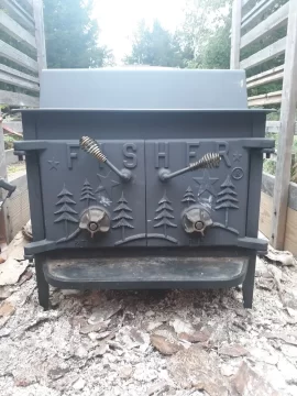

Hello i need some suggestions on a baffle or how to make my new stove more efficient.I also was hoping i could get more info about my new stove.I has the silver balls on the feet...you just cant tell in the picture.

Move to the Fisher forum. There are some examples of baffle installation here and threads on ID.

What do you mean by not ul approved and not extra heat shields? Do you mean you are sticking with the 36" clearance required?

I was asking if maybe it was one of the not lable ul safety ones but still was...just not listed.Yes the UL ones you could get closer to the wall i believe...

If it doesn't have a tag it isn't listed legally. And technically even with a tag if you put a baffle in it the listing would be void. But yes a baffle will increase the efficiency some. But still very low efficiency compared to more modern stuff.

One Grandpa bear for sure has extra heat sheilding....i swear im not crazy.
Yes and that reduced clearances further. But there are unsheilded ones that are listed. If yours is shielded that would be easy to see so no question what it is for safety reasons
Coaly will be along at some point to tell us who is right. I know I have worked on Grandpas that had a tag and no sheilds though
Honestly i dont know...i dont think so...was it just thicker body?...or a second layer with a gap between.Im also wondering about the Concord NH and being stove doors 006 ...wasnt sure how mant where marked this obviously.
The difference is the older style with angle iron corners (I) was tested by 4 different labs across the US before standardized testing by UL was adopted as the national standard. So they are safe.... Just not listed. The models tested to UL Standard is the Roman Numeral III. They have bent corners in front, and integral heat shields. As you read, many fabricators continued to make the unlisted version for where UL listing was not required on and near non-combustible materials such as on fireplace hearth or cement basements. They were $100 cheaper. This is when you find an arched type door installed after 1979 on an old style box. This shows the stove was made after ‘79 when the newer doors, on an old style box.
Installing this stove to the reduced clearance as given in NFPA 211 for unlisted stoves is safe. If your jurisdiction has adopted the International Codes, they technically require all appliances to be listed. This requirement is for a new installation, so many still buy and install, claiming they were existing before the new International Codes were adopted. Older installs are grandfathered and difficult to tell when they were installed. So enforcement is by many insurance companies requiring UL tags as well.
As far as a baffle, use 5/16 thick steel. Make a cardboard template to sit on rear shelf, aim on an angle upward at front towards lower bend. The openomg space smoke travels through can be no smaller than chimney flue internal square area. Insulated liners can use the minimum smoke space, larger chimneys requiring more heat need a larger smoke space. This is easily adjusted by lowering baffle at front slightly opening the space. I set firebrick on edge and set baffle plate on brick corners. Moving bricks fire and aft raises and lowers baffle. Sometimes you have to nip corners on an angle to lower more. Once adjusted where you have the desired chimney temp, I bolt or weld angle iron on the baffle edges to prevent bricks from tilting inward. Not a difficult install. The lower front top will then get hotter than the rear upper, preventing excessive heat loss up chimney as well as temp spikes making it much more controllable.

Were there ever unsheilded Grandpas with tags? Or was someone here putting tags on stoves where they didn't belong? Which is certainly possible.
You’re both right. There were a few early stoves in 78 and 79 tested to UL criteria shown on manuals with no tags, some were tagged. Back then listing was not a big deal. If you have one with a tag, great, it’s listed. Without a tag is considered unlisted today. Fisher started advertising them as listed as it caught on, and some other companies had theirs tested. Smaller companies couldn’t afford it, so many were not. Not many insurance companies were asking for it, and when tags were running low, some went out without tags. If a customer needed one at a later date, one was given to them. It was a time when stoves couldn’t be made fast enough or always keep up with tags.
