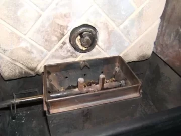

Here's a pic I took a few minutes ago, and you can see the ash build-up on the front edge of the burn pot. It's about 1/2" deep, and that was cleaned last night at about 10 PM.

Light gray ash sound very promising. I wouldn't expect it but you are both reporting that. Awesome!
