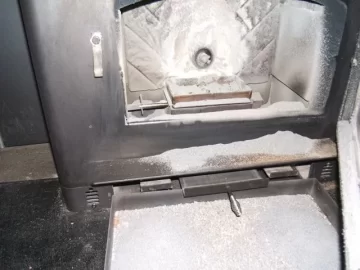

Here are a few more pics I took after 4 bags of burning. I could have gone a little more, but ran out of grass. Also with low temps . on the way I wanted a little hotter pellet. One nice thing is no hard carbon in burn pot, as matter of fact I didn't have to clean it at all. Usually after a week (8-12 bags or so) I have a pretty decent build up of carbon in the pot that I have to bang outand soak in hot water. Worst part of the weekly/bi weekly clean I think. Usually though my pan has enough capacity to go for 2-3 weeks. Grass would be a 4-7 day empty. Man I wish these things had a little less ash.

Yep Schoon, that looks just like mine after the 4 bags i burned. The "pebble" ash in the pan is kinda weird, right?

Yep! same for me too! I didn't have to touch the burnpot as far as chipping out the carbon goes. I just had to brush out them pebbles. But I think my vac got the beating of its very long life time(same vac for the last 10 years)! Wood fiber must have more slag in it or something. Almost every pellet I tested had some slag I had to chip out with a chisel.

Schoon, does the burnpot always end up with new unburned pellets in it after you shut it down? I understand that some of that ash might have fallen off the back wall, but that's a lot of pellets in there.

Yea I see what you are saying. As I remember it was very late night and I told wife to shut down stove so I could clean real quick before changing back to wood pellets when I got home. I was in a hurry and banged the sides a few times then remembered to take a few pics. Thats why the ash on top of the pellets. I'm not sure why there is so many pellets in the pot. Auger still full of pellets and my stove will move auger slowly during shutdown to alleviate chance of hopper fire, or so I read. I guess thats why the unburned pellets.
