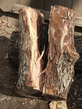

be nice y’all I’m new to this splitting game but figured it would be great exercise and save money from ordering Wood I’ve already split a few loads of wood pecan and hickory that people cut down but I picked up a load of black walnut last week and I haven’t made a dent in it... im killing myself splitting a single round is taking me 20 minutes... I’ve switched to a wedge and sledge cause the axe was just making wood chips of the top any advice?

Wow really? Well damn I’m kinda proud of myself now for sticking with it... any tips for splitting it manually?
Some wood is hard to split when it dries out. For best results, try splitting the wood when it's still green. If you are determined to use the Fiskars, don't try to split the wood right down the center and just nibble around the edges. Or get a heavy splitting maul and some wedges or rent a power splitter if you have a lot to split.
New For sure not Black Walnut.
X2 uh.....yeah, dat not be black walnut. Hickory maybe or a gum. I just bought a splitter, but used to save up all the stuff that didnt split relatively easy and rented a splitter once or twice a season. Otherwise work from the edges, taking off thin splits or chips from the edges rather than trying to crack it in half.
S Or get a heavy splitting maul and some wedges
no no no . . . dude I have tried various splitting mauls/axes/sledge and wedge. . . and then this year my wife's grandmother got me a fiskars. don't fool yourself. the fiskars is the king of hand-splitting. seems like swing speed is everything. we have a homemade heavy as F*ck splitting maul at our huntin camp. then one day someone brought a fiskars back and we laughed at that little thing! well at the end of the day, the fella swinging the fiskars had split way more wood than the rest of us and wasn't half as tired. don't screw around with big heavy splitting mauls. they just make you tired and you get nothing done

I have an 8# splitting maul, a 3-1/2# double edge ax & the Fiskars X27. I just got the Fiskars a couple weeks ago. They make 6# splitting mauls also. As Lost in the Woods has said velocity is more important than weight when hand splitting. I read the science of it somewhere but can’t remember where. When you strike your round hit it more towards the edge rather than in the middle. I have no experience with sweet gum or hickory. About everything I get is Locust, Hedge, Mulberry & Elm. I did get a bit of maple today. I split everything I can by hand, toss what I can’t aside then borrow my friends splitter to clean it up, then return the splitter along with a jag of wood as thanks.
I have researched more and have come to the conclusion it is of the gum family sadly trying to sliver the wood by aiming for the sides just leads to splintering and sending fist sized chunks of wood flying off seems like wedges and desperation is the way forward!

On the gum, I’d recommend not trying to get your usual splits. Just get it small enough to fit through your stove door, then set it aside somewhere to dry. We used to get pieces that my mother couldn’t split with her hydraulic splitter (I don’t know the tonnage, but it’s smaller than a rental for sure). Our stove had a much bigger door than hers, and we could put one or two in and pack around them. They burned great but are a bear to split.
Another use for gum that I’ve heard is to leave a few rounds out for when a woodsplitting friend comes to visit. Show him your technique on your cherry. Then ask for his advice on improvements. Bring out your gum for him to demonstrate.

Firstly, well done on making some moves toward self-sufficiency.
Second, I think your equipment might be holding you back. The Fisher folks made some fine stoves in times past, but their knockoffs of the famous Fiskers splitters are just not cutting it.
Finally, find some wood that's not gum or elm. That Fisher axe would probably be just fine on oak, locust, really anything but gum and elm.
I had a pretty easy time splitting sweet gum after the rounds dried for a year. Just by hand, $29 maul from the hardware store.
