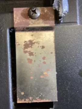

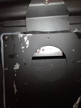

I cannot tell from the diagrams if the air intake is blocked---when I look at the 4" intake hole on the bottom of the stove I can see that there is a metal shield that is bright metal, not black like all the rest, that covers over 3/4 of the hole. It does not look like it is cutting off the air, but it sure as hell is restricting the in-going air.

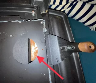

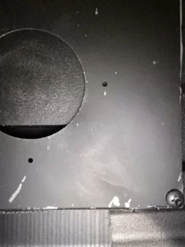

I am attaching two photos, first one shows the intake with the shutter open and the other with the shutter closed. Maybe that bright piece of metal should not be there!!!

I do not think it should be there. I do not have that shiny piece on my stove. We can see what @Nigel459 says. Also, when you close the air intake, I can see the intake damper behind the shiny piece, so I don't think the shiny metal is part of your air control. It almost looks like a piece of extra flashing left in there from packaging or assembly or something.

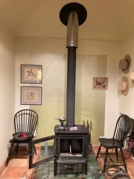

Here is a photo---the pipe goes straight up al the way.

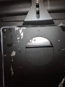

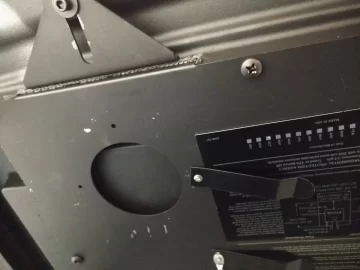

I pulled off most of the panel underneath (hateful job on a Brand New stove) and here are the photos. What you see is the shiny piece that was in the other photos, only now it is uncovered. Does not look like it belong there because it closes off the airflow.

No ceiling support for your chimney pipe?
Anyway. Straight up and out it is. Let us know what you find out on the intake air control.
Good catch! The pipe is actually supported in the attic because that is what the fireplace company sold me. It also has a support where it goes through the roof----so both supports are "hidden" in the attic.

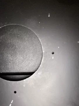

That metal plate is not there on my GM40 stove.
You have me very curious about this! Even with the plate installed on yours I see a small crack of airway. Restricting the air in a similar fashion I have been able to achieve the advertised burn times... BUT only after things are up to temp and cruising. Especially with oak or the black locust I use, one could never get things going without more air!
I wonder if hearthstone is trying to save face putting in these restrictive plates after such crazy advertised burn times?!?

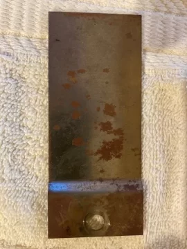

Not sure what you mean by "such crazy advertised burn times" but why they would put a piece of bare metal on the stove is beyond me. NO other part of the stove is bare metal. EVERYTHING is black, treated metal. This piece, which is not more than 14 months old is already rusting!!!n Not right!!

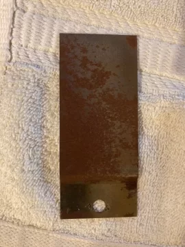

Attaching a couple of photos of the plate, removed, that show it to be a cheap, stamped, untreated, rusting piece of metal. And also a photo of the air intake with the shutter completely closed. You can see that there is still a very tiny gap so that the shutter does not close off the air supply 100%.
I have not heard about these stoves can over-fire easily, or burn at too high a rate because I have never gotten the stove to burn a load of wood properly. However, with your comment I might very well install a damper in the flue.

If it was me I'd pull that piece and see if it makes a difference. Something is definitely weird here. Between that piece, the recalled LPAO, and the overall difference in the air intake between yours and mine, I think hearthstone definitely changed something along the way. I will post some pics from under mine later, it's hard to explain, but the 4" hole in the sheet metal under there, does not line up with my air intake/control. If you look under the stove, you can barely see the gap. I have to stick my pinky finger in there to feel the air control open/close. Whereas on yours it looks like it fills half the hole in the shroud.
It always struck my as strange that the hole in the sheet metal shroud does not line up with my air intake slot. You can barely see the slot on mine, yours is atleast aligned with half the hole.
Unless it's a 40 vs 60 difference. @cabinwarmer would have to confirm.

Removal of the rusted blocking plate has helped give the stove much better draft. However, you still cannot get this stove running without having the door open a crack. Close it while getting the fire started and the fire snuffs out. You need to get the stove up to around 300 before it will allow you to close the door. And once the stove reaches catalyst temperature, closing the bypass actually give better draft. But it takes a long time to get there.

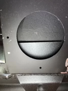

Here is my main opening (GM60) from below the stove. One picture is completely open, the other completely closed. The plate is inside and not visible. I have @ 22' of straight up 6" DVL inside and stainless out side. I have plenty of draft. Light the stove with a top down method. Good example of your stove on the Hearthstone youtube web page for this method. It takes about 5 minutes to get my GM60 up to your 300F (flue temp)you mentioned. I let it go for around 45min and the flue temp over 550F then check the cat gauge and activate the cat. The flue temp drops around 75-100F and I run it there for about 15 min. I then load in the splits on hot coals with a small flame. It take 15 minutes to catch and then I adjust to keep my flue temp around 450F. I get hours of burn at this temp and the cat stays in the middle of the gauge. I have talked with Hearthstone several times (Jim) and he has always been helpful. The number on the web page is 877-877-2113. Was the recall just for GM40? I have not seen anything for the GM60.
added:
* that piece you show is not on my gm60
** one of my CAT's was not installed all the way either, it is from shipping and in my case, the installers. They did not handle with so much care.
I do get some smoke if the flue temp is not hot, you shouldn't have to open the door when cold if you utilize the top down start. Only open when adding wood. To open - Disengage CAT, open intake, crack door, wait 5 seconds and open slowly.
