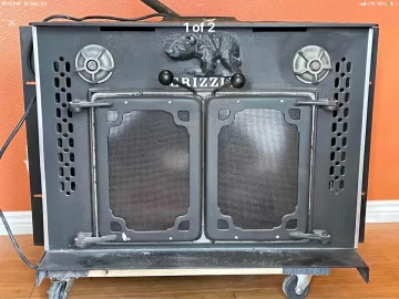

Does anybody know the model and history of this stove? I am considering putting in my outdated open fireplace to try to heat my desert home . Is it a cat stove and what would I need to check to make sure it is in good condition? Thanks for the help!

I highly doubt that is a cat stove. It looks like a copy of a buck stove which is just a steel box basically. To install in a fireplace you will need a full insulated stainless liner the same size of the stove outlet run from the stove out the top of the chimney
Not a copy of a Buck at all but function is similar and it is just a basic steel box. It is a Grizzly and they built some nice stoves, some with some nice nickel plated ornamentation on them. The Grizzly stoves are more common, but yours is the less common insert.

Ok thank you , can someone educate me about needing a stainless steel liner to run up the chimney ? Why can’t you use non stainless steel or use a flex liner?

What would it be made of if not stainless?
It absolutely can be a flex liner that is what it most commonly used
