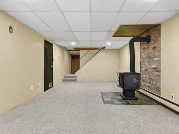

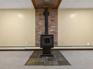

My wife and I are purchasing a home this summer, and it has this woodstove in the attached photo.
Does anybody know what make and model this might be?
At first I thought it was a Quadrafire but looking through the past model photos, I couldn't find anything similar.
I did look for a manufacturer sticker or placard on it but I couldn't locate it.
Any help would be appreciated.

Not sure of the model either, but is that single wall pipe? Doesn't look like its 18" from ceiling if it is single wall.

Good Morning
Unfortuately if there is no Manufacturers Rating plate label on the stove It must be considered an UnCertified Unit. and be wirther 36" or 48" from combustibles. It looks familiar but cannot place it.
The interior blakc pipe, if it is singlewall it does not appear to be the reuqired 18" from the ceiling [ and what is that over the stove?
if a ceiling shield it does not have the required air space for air flow.
