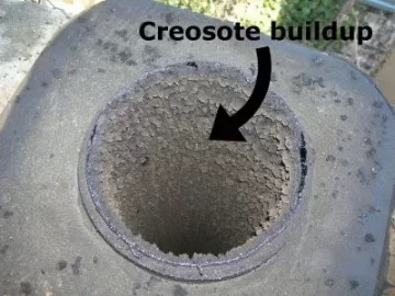

Post a pic of the fluffy stuff. But from your description is sounds like burnt creosote to me.
I didn't take a photo of it but I found one similar to mine on Google. The one I'm going to post is worse then mine was. [Hearth.com] Had a slight incident.  Have a few questions.

I didn't take a photo of it but I found one similar to mine on Google. The one I'm going to post is worse then mine was. View attachment 193636

That's some decent build up, but look like flyash to me, should sweep off fine.
I'm no expert but flyash and creosote are very different

That don't look like burnt creo, looks like flyash build up. There may be some creo under the ash, but my bet is that will clean right off with a good brushing. Caps are the coolest part of the stack, and will get black on the underside. Sure sign of burning less than optimal wood, or running too low of temps. Last couple years with 3+ year old splits, The bottom of my cap was still clean & shiny. I was surprised, & happy.
That wasn't his chimney anyway but yes that does look like burnt creosote where the face has burnt hard and has a layer of grey ash on it.

I am sorry but fly ash does not build up to 1" thick especially in under a full season. But again without seeing a pic of your chimney I cant say for sure. But to each their own if you are not concerned about it I guess I wont be.
