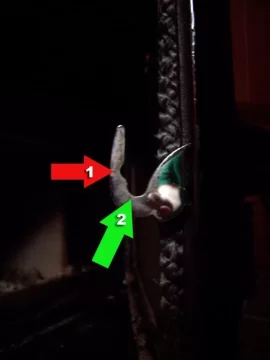

I adjusted the door latch to my Hampton per the manual and I'm wondering if any of you know where the latch is supposed to catch on the handle. I only took out 1 spacer and the door was so tight after I did that I was afraid I was going to break the handle trying to open the door. I don't have a picture of it, but where the handle attatches to the latch there is a round metal piece which can be adjusted up and down a little. I'm wondering if when you latch the door if that piece is supposed to rest in notch #1 in my picture, or is it supposed to seat all the way down at the bottom in #2? Sorry if this question is a little confusing....

Been there done that. The correct answer is 1. I did it by getting caught on 2 and had to know the pin out to get the door to open. Your next question will be how tight should the door fit. Its amazing the seal you get and the door seems loose??? The flames are not dancing so you know it is sealed. I double checked the temp again on my insert...when its going well and choked down just over 200 degrees with the thermometer on the shelf. If it drops below 120 time to load up again. PS, make sure you pull the blower assembly out from underneath it and vacuum the fans, they can get a lot of stuff on them...I have 3 animals and the dust from them and the ash build up. O'yeah, pour a glass of bourbon and enjoy the flames.
