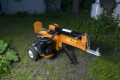

On a seperate question, I noticed in the photo that you seem to have a handle extension of some sort? how does that work? My plan is that I will be running in vertical mode 99% of the time, and the existing handle position looks a bit awkward from the pictures - figured I'd wait to see how it was in person before trying to make any mods. My friend's splitter that I've used in the past has the valve on top of the cylinder, with the handle sticking straight out, which works nicely. I was thinking of trying to make a handle extension that came out at a 90* angle, or possibly a new handle. (Maybe something in a "U" shape that would wrap around the front of the cylinder?)

Yeah, I've fiddled with the valve and can't strike the balance between not popping out on the down stroke and closing at the top of the return (the real problem, I now remember, have not used the splitter all summer). The dowel that I added to the actuator lever is a real handy item for horizontal or vertical use. As you can see, it's just cobbled together. You could do much better with a quick trip to the hardware store. The end of that lever is threaded, so putting a better coupling on there would be easy.
Just curious, but is there a brand(or marking) on the compression x MNPT Elbow? I used to work in the fluid system components worlds and wondering who got the bid.
Thanks!
There is a "12" on it, which I guess is 12mm?
Probably made by The People's Hydraulic Fitting Factory No. 12
