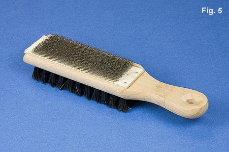

I served an apprenticeship under some of the most creative Machinists around. They recommended chalk in the teeth of a file to help keep it from clogging. Normally you only have a clogging problem with softer materials. A nice file card and brush is handy to have around. Light taps on soft wooden block usually works for me on a chainsaw file to make filings drop out, don't slam any file down unless you want it to shatter into a gazillion pieces. I actually made a filing jig to hold any size saw chain, I usually wait until I need 6 or 8 touched up and head for the bench vice and my jig and takes about 30-45 minutes to do 6-8 chains.
