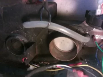

Im glad to hear you found your problem with your stove. I also have an Accentra and when you get the chance, get the stove outside with compressed air and go to it. You will be amazed with the amount of soot that you blow out of the air wash vents and everywhere else that that the vac just dosen:t get. It really, really makes a big difference. If the stove dosen:t have the new feeder, install a cross over tube while you have the stove out. My stove performs much better with the mod. Every year I almost look forward to it. HTHs

ok so what does the crossover tube do? also I am going to pull out the stove tomorrow and blow it out with compressed air. Where should I go at it from and what should I look for and really hit well(problem areas)? also what gaskets should I replace? I was thinking about changing them all but which are the most important and what are the signs or symptoms of a faulty gasket?
thanks guys

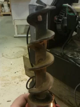

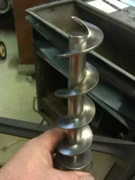

From what I read, it introduces a small amount of air from behind the pellets through the auger tube. That extra air makes the stove burn cleaner and more efficient. In my case I was getting smoke in the hopper, the oak wasn't working to what I thought was correct ( flickering flame). Now I am very happy with the obvious differences the mod has made. When I cleaned my stove I always remove the exhaust fan when I blow it out. Everything blows out very quick except the air wash. Blow into the air wash ,all three sides and in the corners really well. You will be amazed at the amount of soot that just keeps coming. Where it comes from? IM not sure. I has to effect SOMETHING. Clean fins on the exhaust fan, pull slide plate. Clean and blow out any fines. Make sure all four corners of the hopper gasket are sealed well. That can cause the woofing people are having. You mentioned dog hair. Put the stove on blocks so you can get to the distribution blower. Remove it and blow out the fins , they are probably covered with??? everything. And if you are half crazy like I, wire wheel the auger. Enjoy

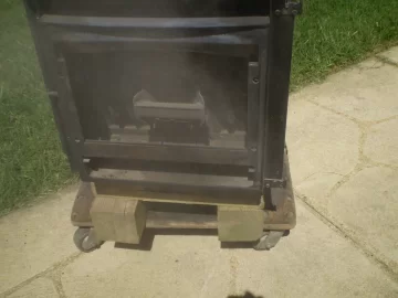

When you can, pull the stove and get it outside and blow every nook and cranny with compressed air. I do it once a year and before I take it outside, I vac ,vac,vac and vac again. when I start blowing with compressed air, it is like I never vacuumed it once. Covered in soot from head to toe. Its a must.
