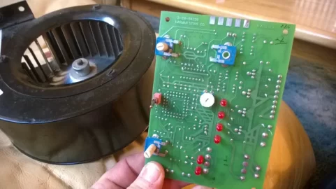

So I can replace those blue thingys on the board easily? I found someone in PA on ebay that will do this for about $50. May try that rather than screwing up the board my self. [Hearth.com] Harman Advance still blinks 3 with new ESP Probe
The ebay outfit says they will test the board also. I have replaced the pots on two boards. The old garage Harman was turning itself on.
So I can replace those blue thingys on the board easily? I found someone in PA on ebay that will do this for about $50. May try that rather than screwing up the board my self. View attachment 144296
Yep. The fifty-buck route isn't bad if you're unsure of your skills with an iron and a board especially if they test the board, that's gravy, but be advised for the longest time I thought I had a pot with a dead spot until I replaced the room sensor. Cured all.
Thanks for the tip about the room sensor. I think I will try that first. At about $35 bucks I won't feel too bad if it does not fix the problem.
