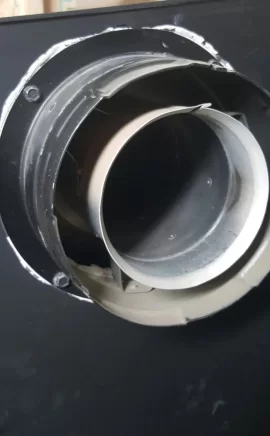

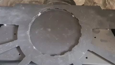

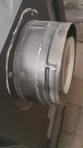

Here are the requested pics-thanks so much for any help :)
[Hearth.com] Harman Conquest [Hearth.com] Harman Conquest
  • [Hearth.com] Harman Conquest
Thanks. It looks like the entire top weldment needs to be removed in order to access the screws.
The rear is pretty obvious. The gasket between the flue collar & the body may be unserviceable,
but RTV silicone will work.
Until you get it apart, the condition of the internal gaskets is an unknown.
Good luck with your project & keep us in the loop. We'll be here if you need more help.

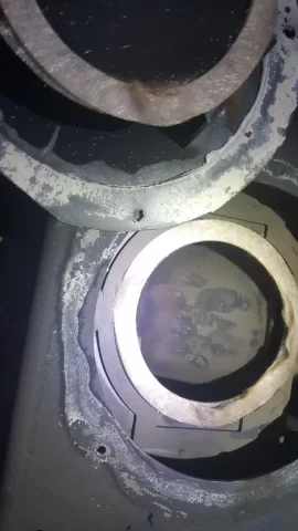

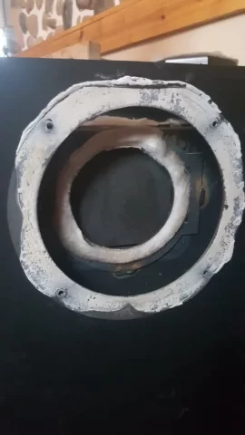

Here is the top after the flue cover weldment was removed:

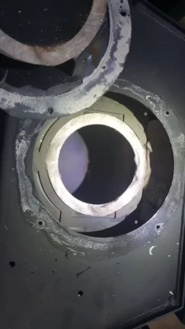

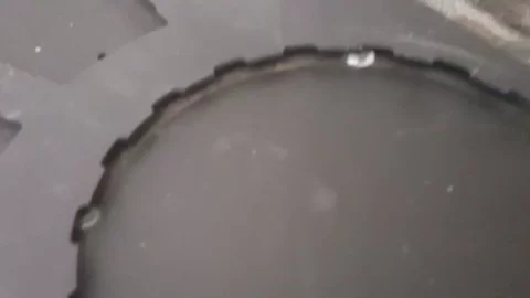

The inner piece under the weldment is hinged and just pushes down over the rear hole to allow for top venting:
So the flue gaskets appear to be a thin layer of fiberglass-this is what you're talking about pulling off and just using RTV instead?
There also appears to be a layer of almost mortar like substance under the outside edge of the weldment/collar also. My plan is to clean that up and figured I'd use RTV there also. Sound right?
Sounds like a plan!
Lookin GOOD!

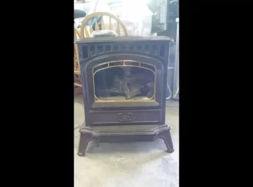

Any idea what manufacturer this is?[Hearth.com] Harman Conquest
Nope. No rating plate on it anywhere?
Hopefully is-haven't contacted the owner yet as I thought I could figure out the manufacturer and do some reading on them, then decide whether it was worth pursuing. Can't find anything with that big "W" on it though to lead me in the right direction!
I've been surprised the number of times I've called/texted people for info and received a response of "I don't know....come look at it". Not my way of selling things but seems to be the norm here.
