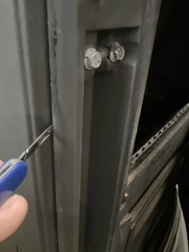

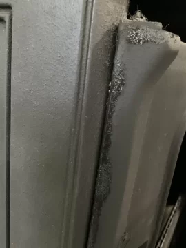

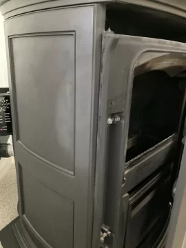

Cleaning my 10 year old Harman today and noticed some ash residue around the door frame on the latch side. Not a lot, just a faint trace but it’s new. The frame appears to have two special screws on either side, not Phillips or straight, can’t remember the name. Anyway I’m sure there’s a seal under it and wondered if trying to tighten them would help or is this a service issue. I’m 78 and 180 rt from dealer

Actually if you look where I have the pointer it’s the frame for the door and the opening…not just the seal around the door, that’s easy. This will be technically difficult according to Harman . They wrote me and said if I decide to have a service technician do it to contact them for a “walk through “ as it’s difficult. But I think I’m just going to run a thin bead of high temperature calk down the seam. Since I live 140 miles rt from the dealer I’m sure it’ll cost hundreds
Ahh the actual frame, ok that is odd. Almost like its out of spec. I would make sure the bolts holding the door to the stove is secure and tight. I think your right, next step clean it out well then high temp silicone in that little area.
