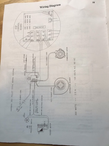

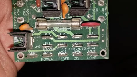

Hi, I am looking for a wiring diagram that shows me how that old 2 knob board is wired up.
I bought an old Harman P38 and the board was ripped out.
To me the board looks good, accept but for the pots.
I would go ahead and buy the board upgrade kit to the 3 knob board.

The two knob manuals/diagrams are scarce, if you do find one please share.
Here ya go...
BTW - My 2-knob is still working beautifully. :ZZZ
Just a thought, I know all the neutrals got together. Are the connectors labeled on the board?
