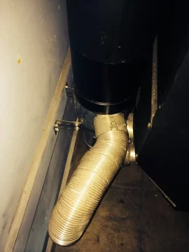

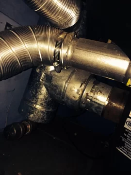

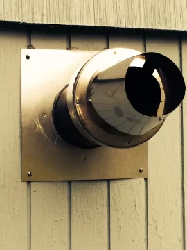

The best way to fight the carbon buildup is by using the Selkirk DT venting that warms and dries the air going into the burnpot. Also makes the stove 10% more efficient. IMHO not the cheapest solution but the best solution!
I'll take the low road on that. I'd think just the opposite would be true, colder denser air should provide more oxygen that hotter air, but what so I know.
