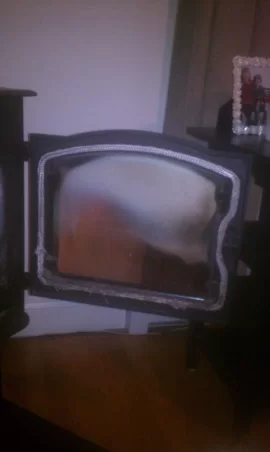

All,
Below is a photo of the inside of my glass after about 30 hours of burning which consumed about 1.25 of a bag of pellets.
Thanks
Glenn

I also just learned that my stove is missing the three fire bricks that are supposed to be behind the burn pot. i don't know if this would change how the air flows through the stove but hopefully that might be the problem.

If you're on a low burn the glass will get dirty faster.1.25 bags in 30+ hours sounds like a low burn rate.Type of pellets can also make a big difference.
Top left part of my glass gets dirty in a day, then it gradually spreads from there. It would probably take 5+ days for it to look like yours.

Something isn't right. I've gone 2 weeks before and mine hasn't looked that bad.

I'm thinking your air wash isn't working/is plugged. I don't believe the MWP's are your problem because that's what I burn.
How old is the stove?
With a P68 only using that many pellets a day it is normal for it to look like that. I have a P61 and it looks like that after a few days of only burning a bag a day. When it gets colder and the stove is hot enough for the distibution fan to stay on constantly you will see better results. I burn Somersets and Turman and they will both due this so its not the pellet. In the past ive used a few bags of other brands and the glass got twice as dirty. Use the Turmans and wipe the glass with a dry cloth when you scrape the pot and wait for colder weather.

The distribution fan shouldn't have any bearing on the amount of ash buildup on the glass.
Reactions: kinsmanstoves
It lets you know that the stove is above an idle. This big of a stove can heat quite on a maintenance burn. When the distribution fan kicks on there was a call for heat and the stove operates above a maintenance burn.
OK. I thought you were inferring that the distribution blower somehow helped keep the glass clean. All I know is, I've never seen my glass that dirty in a week, let alone 30 hours no matter what kind of pellets I was burning or what mode I was burning in regardless of the outside temps. I guess I'm lucky.
Glenn, you need to get the firebrick replaced pronto. Keeps heat from getting to your fuel hopper and bounces some heat to the front, may help with the glass.
Looks like ash sticking to the glass. Rub it off while running with a dry towel, takes 10 seconds. When it cold for cleaning try some Rutland glass cleaner/conditioner this may help with ash sticking. Truman's will probably help too.

I forgot to mention I did replace the fire bricks on Wednesday and it didn't make a difference. I'm going through my last bag of Maine Woods today so tomorrow i should be able to clean the glass and burn some Turmans and see if this helps.
