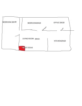

All we know is that it's 3,000 SQ FT on one level. We need to know some temps such as the temp where your stove is located and the far reaches where obviously your current stove is not getting the job done to your satisfaction. Take a few minutes to research and cover your bases to be sure it will work before you plunk down another chunk of cash. What some here are suggesting and I agree is they simply do not want you to get your hopes up, plunk down some more cash and be disappointed. Give us some facts and variables to work with. For example, if your current stove is keeping your place at X degrees and you would like to raise that to Y degrees.

ok ill do my best with drawing a picture of the first floor and main level of the house. the pellet stove is in the corner of the living room blowing into the center of the house. There is a second floor to the house thats not being used as we speak so its blocked off while remodeling. The current stove uses 2.5 bags a day and is always on high heat and blower is on high. with a really good pellet like cubex it'll keep the main living room at 68 degrees and the kitchen at 64 degrees. bedroom to the left is 60 degrees. bedroom accross is the same as living room and the office is same as kitchen. kitchen wall to the living room has a large cutout about 5 feet wide. im mainly looking to keep a temp of 68 degrees in most of the house. if the living room goes to 75 and the bedrooms are 68 ill be estatic and jumping for joy. the englander always struggles to keep 68 degrees in the living room. if using a medium grade pellet im lucky to pull 64 degrees in the living room.
