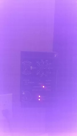

I bought a house last year with a Harmon Accentra in the living room and have been trying to learn how to get the most out of it.
My question relates to the distribution blower when the stove is in room temp auto mode. It seems that once the room temp probe is satisfied, the distribution blower turns off and a small maintenance fire burns in the pot until the probe calls for heat again.
My question is; is there any way to force the distribution blower to stay on? It seems like a waste of heat (and pellets) to have it off with a hot stove and fire burning.

If your stove is on AUTO, which it looks like it is, it should be shutting down once your room is up to temp. Are you giving it enough time to realize things are warm and it's time to shut down?

The distribution blower turns off when the room is at temperature. I want to know if there is a way to keep the distribution blower on while the stove is in maintenance burn mode in between calls for heat.
Or are you saying that the stove should turn totally off in between calls for heat, and not maintenance burn with no blower?
Yes, if it's set to AUTO, the stove should shut down after a short time when the heat requirement has been met.
I think you can set it to STOVE TEMP and the blower should stay on, but you're likely to overheat your space, and seeing your concerns seem to be save pellets, that isn't gonna be your best option.

Interesting. It's been in low burn with the blower off for hours with the dial temp set at 65 and the room at 65 too. I turned the dial down to 55 about 45 minutes ago and no change.
The p series can radiate a good amount of the heat of a small fire so letting the stove run is a good option in cooler weather as it will ramp up and quickly to keep a larger area from having a large temp swing and save on igniters
I'm not sure at that low of a setting if the blower will ever kick on much at all.
I mean it appear to me the higher the temp u set the more the blower will run as opposed to the lowest settings.. I don't know. maybe I have it backwards..
on Room temp/Manual or Stove Temp/Auto once temp is reached, both settings will go into a low maint burn Dribbling a few pellets to keep fire going but the Dist Blower will deffinilty
shut off for a while...
The ESP on Stove mode or the Wire Temp probe on Room temp sez Ok. Temperature has been reached.. Bye.
But to answer your original post, I know of No way to keep the blower running constant..
I used to think of it as a waste of pellets also[Maint Burn] but the stove would cool down so much on Room/Auto, [high flame/low flame/No flame that to bring it all back up again to me seemed like a bigger waste. Not to be confused with days where the Sun warms up and stove would be off for most of the day in Fall weather. That would be a savings on pellets..

Dealer thinks it's the ESP probe. Going to replace that and see if anything changes.
