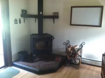

Here's my timberwolf 2200 set up the reason I went with the timberwolf over the englander nc30 was strictly due to clearences , with double wall pipe I beleive u need 7 inches to combustibles on a corner install the englander was a much bigger number and I didn't have the space. Just something to keep in mind.
