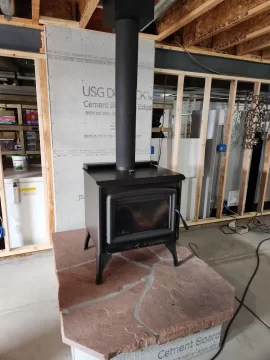

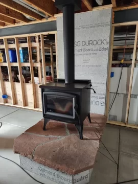

Just wanted to update everyone. Got the new stove in! BK Sirocco 30.2. So far so good! But man that first fire was rough... all the oils and stuff were burning off and set off my smoke alarms... everything is fine now, slight odor but not bad. Anyway my flue ended up around 28' my Elevation calls for 17- 18' of flue so I'm about 10' more. So far I think Ashful is right about the basement effect partly canceling out the long flue. Drafts perfectly fine and issues with control so far. We will see what happens as time goes on with fly ash plugging combuster and what not. Everyone's advice is much appreciated! Thanks all!
