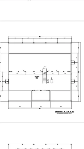

The basement, is it a walk out type of sub underground? Are you going to insulate it? do you have an existing chimney or are you planning a new class A? How tight is the house currently, do you suspect a negative draft issue developing?
The basement is not a walkout. It is completely buried in the dirt except for the south wall is 2' exposed concrete. It is currently insulated with r19 drape insulation. I am planning on new class a chimney...there is a perfect spot to run up between my floor joist with a 6" class a and build a chase around it in the living room against the kitchen wall then brick it to make it fancy. I thought I did a good job with making the house tight when I built it but silly me skimped out on windows to stay in budget and now I'm regretting that decision...🤦‍♂️
The other thing is (regarding cranking out peak performance) do you want a stove to carry all heat, even in the three worst days of winter? Or do you want a stove that can do well almost all the time, and you add a few gallons of oil (or whatever) to top up the stove output in those three worst days? (And then being able to heat nicely when it's 40-50 outside because of the turn down capability5 of the stove.)
My goal is to have the stoves carry all the heat. Propane is ridiculous I just forked out 566 bucks for 250 gallons of propane that was for December, January, and part of February...granted the HVAC system was installed incorrectly the first two times and fired that guy and the new system was installed in January and runs WAY better...but still propane is just plain expensive. I feel like if I pay 10 bucks a cord to go to cut my own wood from the national forest and use 4 or 5 cords a season plus gas and stuff I'm thinking I can heat the whole house all winter for like 200 bucks. The cost of the woodstove would pay for itself in like 4 years. We got some week long stretches this year of 10 to -26. Granted the -26 was one night but that whole week the high for nighttime was -2. That really sucked the propane that week. I had my valcourt blaring and furnace would run at the same time the fireplace was running. Bleeping cold for sure.
Edit: that 250 gallons was with running the valcourt 75% of the time. And the furnace kicks on every morning about 4-5 am because the valcourt just runs out of steam by then
Carry all the heat for the basement or for the whole home? (Given that you note a propane bill that is presumably for the whole house.)

Once the basement is finished, the heat loss will be less. A T5 or Jotul F45 would heat the basement and can provide a 10-12 hr burn between reloads. If the goal is to heat the whole house then a T6 or Jotul F55 might be a better fit, assuming that there is a good convection path for the heat to get upstairs and for the cold air to return to the basement.

The basement has r19 drape insulation currently. Will add r13 to the 2x4 walls once finished. So that's like having a 2x10 wall full of insulation. That's super thick.

Ok. So it won't carry all, it'll heat the floor and provide additional heat for the main floor. That's good.
Regarding vents. The first thing is to have a fire-safe configuration (i.e. check local code or ask your fire department).
I have the following.
Basement stove, open stairs to the main floor. I cut a register in the main floor, metal boot, fusible link fire damper, flexible duct. That duct goes between the joists to a sidewall where it comes down to the floor of the basement. At the bottom there I have an inline duct fan (188 CFM when running freely).
I use the fan to *suck* the coldest air from the main floor and deposit that on the floor of the basement. That puts the coldest air on the basement floor, pushing up the warmest air to the ceiling (keeping things stratified), which then rises through the stairs to the main floor.
This avoids forcibly sucking air from the stove area - always good in case you forget to open the basement door (CO, smoke, etc. - always safest to push air to a stove rather than pump it away from a stove room), it takes the coldest air from the living room and pushes up the warmest air. And it has the fan on the basement floor rather than connected to the joists of the living room floor (noise!).
And then I have a smoke/CO detectors (of course on all floors) but I added two right at the ceiling where the warm air drifts up into the stairwell from teh basement to the main floor.
This works well for me.

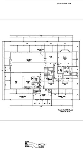

I don't know what spaces you want to heat (LR heated enough by the fireplace there?). Kitchen? Bedrooms?
Your bedrooms, office etc. will remain colder, unless you add some vents there too (those may need to be larger, and you'd have to tune how far you open the door of the stairwell to balance flows). If you do this, a 6" duct and fan may not be enough (i.e. go 8" or 10").
The issue is that you have quite a few small rooms with limited airflow "circuit" options unless you make a lot of holes in floors. I wonder if your issue with the heat output of the Valcourt for your home is more of a lay-out issue rather than a fireplace sizing issue?
To heat all spaces, you need airflow to *and from* those spaces. With a single door as the only entry to a space, that can be done by having fans on the floor *slowly* blowing cold air towards the stove. Warm air would replace this, after traveling along the ceiling. But your hallway is rather restrictive to get enough warm air to all the rooms on the right hand side. It'd have to turn 3 corners in a narrow hallway to reach BR2 and 3. That's tough however you do it.
In any case, think about air *circuits* rather than a single lane (hallway) of air, and the layout of your home.
Maybe a bigger ducted fan in one strategic place (but bigger = noise; hallway near the stairs?) and more medium sized registers (w/ fusible link damper) for rising warm air where you want heat input above, and keeping the stairwell door closed is a better strategy? It gets complicated quickly though.

I am surprised that the heat upstairs is so even, but that is a good thing.
Adding a (one) register with a fan would create a flow with a preference for going (from the stairs) to that direction. So you have to figure out which room you want the largest temperature increase and add that register there. The rest will also become warmer.
The efficiency of having no register depends a lot on the stratification of the air in your hallway, and I'm afraid that would not be great given the fan of the valcourt.
But you can try without register first before you cut in the floor.
