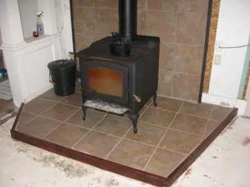

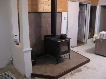

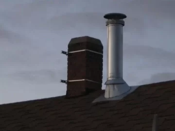

A week or so ago I posted the long story of our (at the time) unfinished hearth build. We have now finished and installed the stove and I just wanted to share for anyone on the fence about doing it yourself; it can be done (even by a tile-challenged individual like myself!).
Basically OSB with metal studs and 2 layers Durock; ventilated for air movement. Pay no attention to the rest of the house, it's "in progress" we bought it as a "handyman special".
Thanks to everyone on the site for support and the excellent resources here.

Pat yourself on the back, it looks great.
I know how much work is involved in that sort of thing. I spent November skimcoating an interior masonry chimney with Conproco Structural Skin to get a smooth, paintable surface. I did the tiling on the hearth, too. You will note that I did all of this while the husband was safely at work so I didn't have to suffer the learning curve under his (only slightly more experienced) gaze...
Thanks for the pictorial update, feels good, huh?
Looks Great. What stove is that?
That's a fine looking install! Congrats on the hard work, it turned out really well.
I certainly appreciate the challenges of being a first time tiler. At least you were smart enough to not use slate like I did. :)
Looks good.
Thanks - Slyferret it is an Englander NC-30; we switched from the pedestal to the legs but they were a pain to swap. Now that I've tiled the hearth, my wife wants me to do our kitchen floor!
