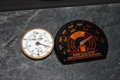

Just an update on a test from this morning. I found this very interesting...
The top of the stove is running at 350 degrees
The stove pipe (on the T section) is running at 250 degrees
What does that mean????
It can mean one of two things, either you have 250 degree air cooling the 350 stove top as it heads for the chimney, or you have a measurement error.
This morning I threw in a three dry splits on top of an already hot fire and walked away.... the temps began to run away. I had to close the stove pipe damper and the air control to stop it from rising.
You can get these things hot! I knew it because you could smell it.

Like Milt said, you could have an error, or that fire is lazy due to poor wood.
I created a thread yesterday on getting a Hearthstone up to temp with good wood showing pictures of what the temps where and what the fire looked like. I had you in mind when I made the thread. Does your firebox look like mine when you have the fire going?
https://www.hearth.com/talk/threads/83823/
My burn has a lot more flames. More flames at every step you posted. The difference is maybe your stove damper. I am going to install one. I figure it can't hurt to install. I will also try using (Hardware store wood - Dry dry) and see what happens. Again Thanks for all your suggestions. The project is fun to figure-out.
A lot of flame is good since that does mean your wood isn't sopping wet. Give the damper a try, maybe you are just losing a tone of heat up the chimney. That is an easier, and cheaper, solution than if you were dealing with wet wood supply.
I'm assuming you tried using the air controls with the same method? Did you at least top out at a higher temp, or is 400 still your high?

400 is still the highest temps i achieved. I tried the 20-10-10 thing. It is interesting and seemed to work somewhat. With hot coals in the stove the pipe is cooler than the stove by about 100 degrees (I purchased a second thermostat to check the first). I think the heat is being sucked up the chimney. I will install the damper with high hopes of keeping the heat in the stove box.
