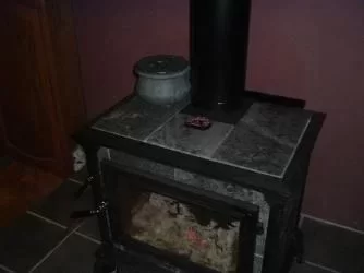

Lastly, the manual does not warn you against putting anything on the stove. Quite the opposite, they make and sell stovetop soapstone kettles. Mine came directly from Hearthstone.
I use smallish wood as described above. Sometimes even stuff the stove full with 4 blocks of 5x5 wood. I am currently burning 14-16" long splits but the next 9 cords were all cut to 18" long to help fill the box.

Guess I'll have to dig out my manual and read it again. Thanks for the heads up and I'll try your suggestions this weekend while I'm up in Maine. I need to buy a decent thermometer to get an accurate temp. I thought I read in the manual that putting anything METAL on the stove was a no-no. Didn't know they sold soapstone ones.
The stone is soft and can be scratched easily. I believe you can even carve it with a knife. I make for darned sure that there is no grit beneath the kettle and I fill the kettle in place from a transfer vessle to avoid moving the kettle around. I am not concerend with breaking the stone as much as I am about damaging the glossy finish of this soft stone.
