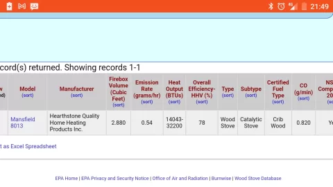

Hearthstone's overenthusiastic marketing is not really helpful in this regard. It can be misleading. The Mansfield's EPA rating is 14,043-32,200 BTUs/hr.

Mansfield test here
