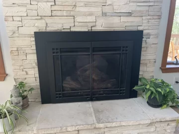

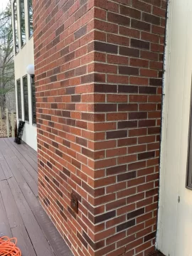

A decoupled Mendota gas fireplace insert (note not a fan at all) inserted into a masonry chimney. The dimensions of the hearth are 36”w x 19d x 29h plus there is a 15” section that extends beyond the hearth opening if that makes sense. This means there is 36” deep area for the stove to sit depending on how far back we want it. I know on the Progress Hybrid some of the controls are on the side towards the rear so need to be aware of that.
Attached are some pics of the current Mendota and the exterior chimney. Note we had it inspected prior to purchasing the house this past fall as it is in very good shape. We will have a chimney sweep clean it first of course after the current liner is removed. Also note my plan is to do this myself with a 6” smooth liner and blocker installed. Moving of the stove into the house will be done by motorized dolly that climbs stairs and if we go with the Progress Hybrid, we will pick it up and offload at home with forks on the tractor.

I was just about to comment that you will need a rear-vented stove that clears the 29" lintel. The Chinook is 35.5" tall, the Ashford is 33" tall. Both are top-vented. It's not catalytic, but the Jotul F55 has a short leg option that drops the rear vent height to about 27".

I spoke to Woodstock today and they confirmed with short legs, the center of the rear exit is at 22.75” so that will be fine for my hearth. Now I want to get a look at the Jotul 55 as they make them like 35 minutes from my house and they are about $1k less expensive. That $1k could go towards the grapple I want for my tractor to make hauling logs out of the property easier.
