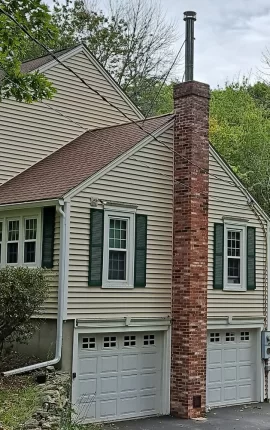

some of this info has been posted in a different thread but want to keep this comprehensive for this stove so adding it here.
confirmed that my chimney setup is as follows:
  • rear exit into adjustable elbow with 4" rise, ~1ft length
  • uninsulated tee with 18" snout, had 1/4" rise per foot
  • 16' 5.5" uninsulated liner
according to the manual it should be:
  • 16.5' 6" insulated liner
i'm upgrading the following:
  • ~15.5' 6" insulated 316ti liner
  • insulated tee/snout
  • 5' Class A
So I should have effectively 4 ft more chimney height
Smoke rollout was my main concern, but I'm hoping that this will solve the problems I saw with the air wash igniting secondary combustion resulting in high STT. My thought process being; as I closed the primary air the total volume of gases going up the chimney decreased. This caused the flue to begin to cool (not insulated), which reduced the draft causing a reduction in velocity of the gases. Even though the STT and gasses were hot there just wasn't enough volume to keep the flue warm. Everything still went up the chimney, but there wasn't a lot of movement, so the stove got hot, the wood off gassed and any air introduced caused secondary combustion.
total chimney height is now ~21.5'; hoping this along with the insulated 6" liner fixes the draft issues I had last year

That should make a notable improvement. Keep us posted.

haven't really got a chance to test out the setup below 39 degrees. only had 2 actual cold starts (beyond the break-in fires) and no hot reloads.
the only thing i feel confident in commenting on at this point is smoke rollout during cold starts. i've been warming the flue with a heat gun prior to starting the fire, lighting a top down fire using newspaper, cracking a nearby window open 2".
  • on initial lighting with the door wide open and primary 100% open the flames and any smoke from the newspaper seems to be sucked up the flue and i can't smell anything
  • as the kindling begins to light any smoke that is released looks like it is going to get pulled up the flue but some of it starts to swirl up around where the baffle/air wash and I can smell smoke and see some escape
  • with the previous setup any smoke from the newspaper would rollout the door
I believe primary air feeds the air wash on this stove; so I'm wondering if I were to shut the primary during a cold start when the door is open would I resolve this issue of smoke turbulence from the air wash and thus no smoke rollout? Obviously when i close the door to "just cracked" I would open the primary inlet 100%. thoughts would be appreciated.
