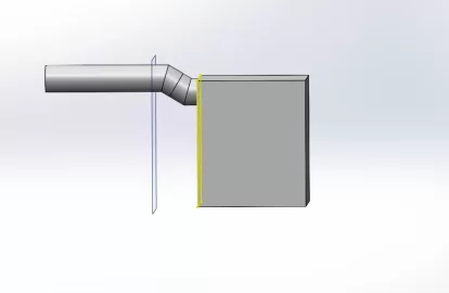

Decided I want to update my flue setup again. The rear install is something like the image below now with an adjustable elbow that is more or less (2) 30-degree elbows butted up to one another to make up a difference of 3" in height between the stove exit and my thru-wall thimble. I'm not totally satisfied with the integrity of the pipe in this orientation and I assume changing it to a straight pipe would improve draft/performance (albeit maybe slightly). To make up the difference in height I'm going to put the stove on 3" thick concrete blocks (probably these: lowes retaining wall blocks). If I like the setup and performance seems to improve I'll spend the time next year to lay a layer of bricks/mortar to replace the concrete blocks.

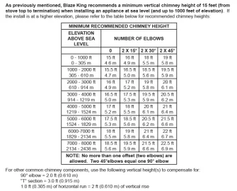

Hearthstone support is pretty useless and the manual has conflicting statements about minimum chimney height requirements for the 8372 Shelburne in a rear exit configuration. So I'll assume the 16.5 ft from the top of the stove to the top of the chimney is the correct statistic. BlazeKing has a table for chimney height recommendations based on elevation above sea level and chimney components in your system (elbows, etc). My assumption here is that I can just plug my minimum height requirement in and use their height recommendations in kind.
I'm at ~500 ft and with the modifications mentioned above will have ~2.5 ft horizontal run and a T "section". So based on the below that says I need minimum height (16.5ft) + 8 ft = 24.5 ft. The current chimney is 21.5 ft from the top of the stove, so that means I'd need another 3 ft section of class A. Does this seem correct?

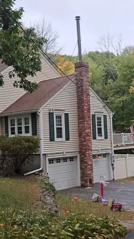

How much class A chimney is already attached to the masonry chimney? I'd be a bit concerned that at some point, the leverage of the unbraced pipe might become an issue.
It's currently braced. I have a 1.5 ft + 4 ft up there right now.

While I was up there I added another 4 ft section of class A in hopes of finally fixing my smoke rollout issue. Total height is ~25 ft from stove exit.
