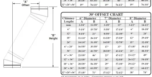

Is this Supervent pipe? The offset tables will provide you with the height and offset you will get using 30 deg. class A elbows. You may be able to drop down the class A ceiling pipe and raise the roof pipe enough to fit with 30 deg elbows and a short connector pipe. The offset table will determine whether this is possible or not in the distance between the top of the insulation shield and the roof. If the roof pipe gets raised a foot, that will be good. It still looks shy of 3ft. This is not measured to the top of the cap, it is to the top of the pipe.

Both the sections of class A can adjust up or down. I'm hoping that with a pair of class A 30 deg elbows and a short connector that the offset will work out. If you can do it with a 12" connector you get an 8 1/4" offset, with an 18" connector you will get an 11.25" offset. Worst case scenario will be to patch the hole and make another. That's a bummer, but not the end of the world and certainly not worth ending a friendship over. Buy your buddy a nice gift, bottle of wine or booze and let him know there are no hard feelings.

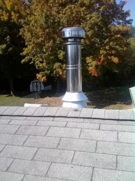

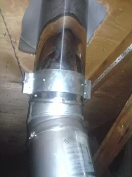

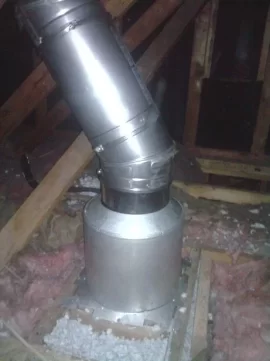

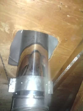

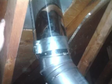

Got it fixed today. I thought I had pics of the chimney. I'll get more tomorrow. I had a certified installer out today. We got er done and have a nice fire going. It cost a bit, but my wife and I will sleep better at night.

I am so glad to see that you got it done correctly it looks great! Enjoy that new stove now.
There ya go Sheepdog,enjoy.Now you and the rest of us got that piece of mind.Now you can get that Shelburne up and going and KNOW that it's right.Rest easy,you've made some new friends.Oh 1 more thing,BURN PICTURES!!!!!!!!
Great. Looks like an 18" connection between the elbows worked. I'm glad you could use the existing hole. Hopefully that pushed the pipe up a bit higher above the roof too.
Enjoy the new stove and don't be a stranger. You may have had a bad situation, but you dealt with it well.

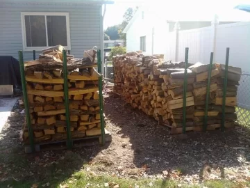

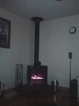

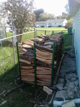

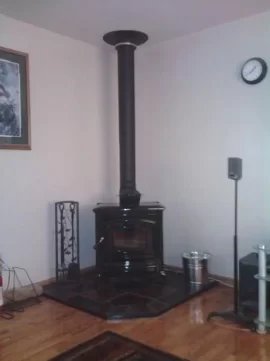

Thanks for the replies. I would not take anything personal as I have very thick skin. Plus, I don't live in a glass house..... ;-P I came to this website to learn from the experts and get good honest feedback. The clearances on this stove with double wall pipe is 6" from combustibles from the ceiling down. The chimney pipe may look crooked in the pic, but it's not, that's just my photography skills. That night I had a small bed of coals from some paper and tinder that I set only 1 log on. That log was about 19-20" in length, 6" wide, and 3 " thick and was seasoned a couple of years. It got so damn hot in my house that I put on the fan in my bedroom and opened the window. I think I lost a couple pounds in sweat that night. The pics of the two lanes of wood are various hardwood. That's next years stash. I need to tarp the top and It's gonna sit and season. The single stack is 90% apple and the top layer is Honey Locust. It's also getting tarped and forgotten for at least a year, maybe two.

Looks great and ready to rock and roll! I like that stove a lot.
Don't worry about overheating, when your temps drop a bit it will be burning steadily. In the meantime just make small 2-3 split, hot fires and let them burn out.
Congrat on the installation & correction. The pipe work looks great now. But make sure that the stove clearance from the wall meet the minimum requirement. May be it is but the picture makes it looks pretty close to the wall.

Got a nice spread there, along with the nice wood!
