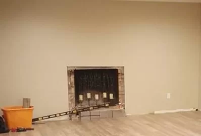

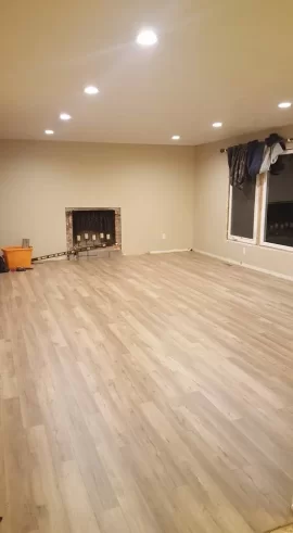

I am posting pictures of our living room area and the fireplace opening itself. We will be cutting the sheet rock around it and installing a cement backing along with tiles with a hearth when we get the insert complete.

Valor is a Cadillac fireplace. Great radiant heat. The blower is optional. In this case get it. You won't be disappointed with the fireplace. The turn down with the gas valve is second to none. Works great on milder days.

If you're not planning on building a hearth get a four-sided surround. If you are planning on building a hearth get the Clearview front with the Vienna feet.
