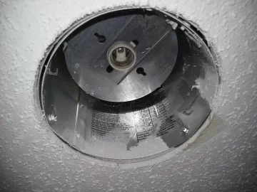

I was always envious of you all saying your home was more evenly heated then mine, I was seeing on cold mornings under 25f over a 10 degree difference in temps between my living room and dining room in a small 1500sqft Cape, this morning it was the usual 59 degree's in my kitchen and almost 70 in the living room where the stove is.
My home was built in 1952, It was gutted in 2007/2008 and most walls and ceilings were replaced, before I bought it in june 2008, they added 7 recessed cans in my kitchen and what was a breezeway between the garage is now part of my living room, last week I replaced all my BR30 bulbs with LED Philip's bulbs that were onsale at HD, I knew for years that there was serious cold drafts coming from around the lights, I pulled off the rings and where they cut the holes there was some serious gaps and cold air was coming in, I caulked around the gaps and now it feel's alot warmer
. [Hearth.com] Heat loss thru Recessed light's
.View attachment 148928
What is above the cans in the kitchen? Is/was it insulated?

Doubt they added any as it's inside the main house, have you ever seen insulation between downstairs and upstair ceiling? It's 17 out and today it's 65 in living room, 57 in dining room....so that I guess didn't help as much as I hoped, only burning on a 2 using AWF White Pine, burning on a 3 really sucks down the pellets with maybe a 10 hour fill time max
If you take into account all of the little holes, gaps, cracks, and such adding them all up in the average home and equated that into you have a hole this big in your wall peoples chins would be dropping and bouncing off of their floors. It is often overlooked and not considered or thought about much, but as more are taking a beating paying the big bucks to keep their Swiss cheese castles heated they are slowly becoming aware. I suggest looking into an energy audit. Many local utility companies offer them and many times they are free of charge. It takes more strain off of their grids too. Win - Win. Worth checking into and asking about.
Can lights are a big air leaks if not properly sealed. Another point on the cans in uninsulated ceilings between the 1st and 2nd floor is the fact that those joist spaces go all the way out to the band boards. They are supposed to be insulated at least at the band boards along the outer perimeter. My next point is that in the uninsulated joist spaces the cans are in they are wide open except where there is supposed to be that little bit of insulation at the exterior perimeter.
Most builders sub out the insulation. Itchy and Scratchy who are the two dudes that show up to jam it in are often paid by piece work so they are not as worried about your air loss as they are about the sack of weed they have hidden in the van. The quicker they slam it in the more they make and the quicker they get to fire up the happy hay. That said, it is already water under the bridge and your best and least expensive option is to make sure the can housings are sealed. This is not just running a bead around where it meets the drywall but also includes un-doing the wing nut and dropping the bulb socket and shield. Up in the can above that many housings are not sealed especially if they are older cans.
Cans are not a one and done proposition. There are IC (insulated) cans and non. Non-IC'c cost less and they are often used whenever Joe Schmo the builder can get away with it. To add to everyone's enjoyment many building inspectors are slackers who don't care as much as they should because it's not their home and heating bills. Plus they like to go golfing and knock back some oat sodas with Builder Bob at his annual outings. It's up to the homeowner to look out for their heating cash.
The cans actually come in a few varieties.
IC is rated for "insulation contact". It has a thermal limit switch in it to prevent the fixture from starting a fire.
AT is "air tight". This is what is really important for controlling air leaks.
ICAT is both air tight and rated for insulation contact.
The type is always marked somewher on the can. If these were installed as a remodel, they can probably be removed and replaced with the better cans fairly easily. They are held in place by spring clips. The cans are relatively cheap (around $10) and the cost may be justified by the comfort and fuel savings.

Harvey is correct and Thanks! I should have been more clear on the ratings. My main point was these empty joist spaces usually get non air tight and non IC housings. The leaky cheaper seats type. Some old can houses have nothing really. Sorry for any confusion.

Of my 7 cans in the kitchen 5 are what appears to be sealed as there's no slot's or holes in them, 2 have various slots on the sides but those dont leak much cold air as the other's did.

I saw those but went with the new philip's blulbs for $8 each, the drafts were from the hole around the can, sealed them yesterday, most of the cold air is gone now, cranked the stove up to a 3, now it's 77, the difference between 2 and 3 is huge for heat output on the Whitfield
These are always an option? They are dimmable and they seal up to can to stop air passing through them.

Finally installed mine in the garage about a month ago. Had torn out the ceiling and put more insulation between that and the bedroom floor, then installed the recessed lights and sheetrock over the summer. Just had incandescent bulbs hanging loosely waiting for me to put the dang LED's and covers on. I can tell you just installing those made a difference on how cold the bedroom floors get.
Edit: Hey, and my electric company gives $10 rebate per light/cover too!
