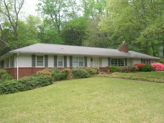

My fiancee bought a nice big brick ranch style house in Asheville NC several years ago. It had a heat pump, probably installed in 1993, that thing was a piece of crap and the tenants had massive power bills, always complaining about the house being cold.
That POS crapped out 3 years ago. We have a very good heating and air company, because Shirley has 4 nice big rental houses here in Asheville. Our heat and a/c company recommended replacement with a new heat pump, claimed performance was way up etc etc. I now suspect our heating and air company got a cash rebate from the electric company, otherwise I don't know why they would have urged us to get this new heat pump.
We were inclined to go with central gas furnace instead but let this guy talk us into the heat pump. Biggest mistake we ever made, it is the same story I knew so well back in central Georgia, except, Asheville is, day in and day out, 20 degrees colder than central Georgia.
Tenants complain that the house is not warm enough, and they run up massive power bills. We get the heat and air company out there 3 or 4 times every winter, to see what is wrong, etc etc. They will replace a thermostat one month, or they will adjust something the next month, but it is always the same story.
Now, this is not a geothermal heat pump, I am talking about a straight electric heat pump.
If y'all are happy with your heat pumps, God Bless You. I have been involved in the construction trades for 45 years, I have helped manage 5 nice rental houses for 25 years and I have seen all I want to know about heat pumps.
Our other 3 rental houses in Asheville all have central gas heat. We get no complaints from tenants, their houses are warm and gas bills are reasonable. All four of these houses are similar, almost indentical, ranch style houses built in the sixties with lots of retro fit attic insulation.
[Hearth.com] Heat pump or wood stove
Our Asheville house with the demonic heat pump. Need to get an exorcist to come out and cleanse the house of this heat pump.
