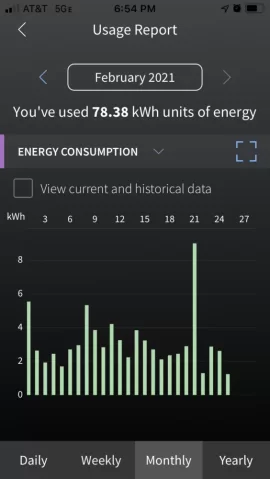

I have a Rheem 50 gallon for 4 people. It comes with an app where you can vary the temp and heating mode on a schedule. I have it heat up to 130F during the day (while power comes from my solar panels) using the heat pump only. This to give a bump for the high demand time. During the evening, when most people shower I run in high demand mode but at 120F and then back to heat pump mode at night at 120F.
Without the solar I would pay about $10 a month.

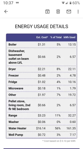

My guess is you're right, and the culprit is the water heater. I have an electric water heater too and I knew it was a big part of my energy usage, but until I installed a consumption monitoring device on my breaker panel last fall, I didn't realize quite how much energy the water heater used.
I got the Energy Curb monitor which gives you CTs (current transformers) for the mains, as well as enough CTs to monitor several individual circuits too. It was pretty eye opening to see the actual usage numbers on the water heater. Curb sends you an email each week with your weekly energy usage report:
