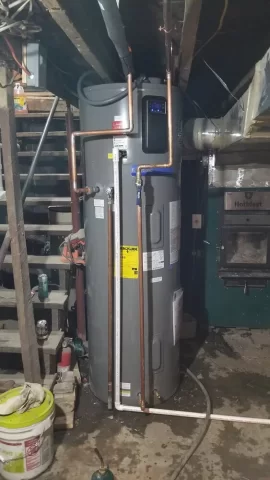

I've been working on drying the basement and repointing the old stone foundation on half of our basement. With all the work I've put in, I decided to purchase an 80 gallon heatpump waterheater from Menards. It's a 220 30 amp 80 gallon model. The benefits of dehumidifying the basement and saving money make the purchase worth it. I'm predicted to get the heater by the 17th of April. Once I install the heater I'll update the thread.

So I'll be installing the new water heater this weekend. Since the joists are basically touching the top of the unit, I'll need to restructure to give proper clearances (minimum). What I am wondering about is currently I have a peak load management system on the current heater and I'm unsure if those types of systems are compatible. I feel I should remove the peak buster since the new unit is much more efficient. Either way I'm excited and can't wait to see the results.

I am assuming the peak load system is managed by your utility company?? I guessing the heatpump uses about 500-700 watts. Don’t see it being useful. The power off-on startup routine on mine runs through a self diagnostic. Takes several minutes to complete. I would prefer not to have routine power disruptions to but it probably would not hurt anything.
I don’t have full 8’ ceilings but didn’t have a clearance issues but I am wondering how one would change out the anode rod? Tip it over?

I would think so unless the heater had a flexible anode rod. Says it has a premium magnesium anode with resistor. I did confirm with a friend who works for our Co-op that confirmed the peakbuster is not compatible (which I figured). I read that load management boxes could actually cause the heater to consume more energy if the water temp fell too much and the elements kicked in. With the unit having active monitoring and Wifi I'll get to see how much our hot water costs.

Break/bend the old one as it comes out.
Install a multi-sectioned one. They look kind of like nunchucks.
