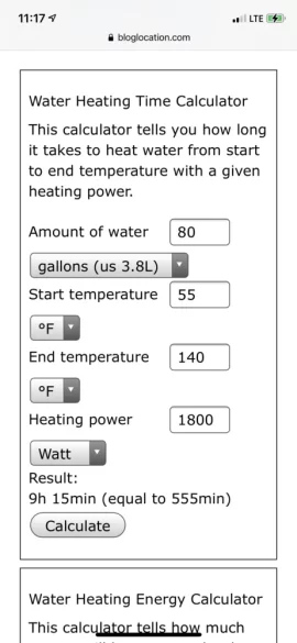

Here is my rough estimate of how long it would take to heat up 80 gallons to 140F. I chose 1800w because the rated COP of the heat pump is probably close to 3 and runs at close to 600 W. The electric elements may be able to get to temp in half the time. And the quick recharge element could get the top of the tank up to temp even faster. YMMV. I’d be putting low flow shower heads and sink aerators throughout the house, and use the dishwasher delay if you have it just to make sure she is always happy
Evan
  • [Hearth.com] Heat Pump Water Heaters

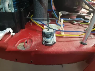

Also, make sure you flush and check your anode rod on your heat pump water heater. My anode rod was completely gone after 5 years.
