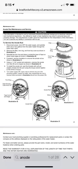

Also, make sure you flush and check your anode rod on your heat pump water heater. My anode rod was completely gone after 5 years.
I took the top of my old AO Smith HPHW off when I was having issues with a few years ago. I think I'd need every 1/2 extension I have to get the anode rod out. The sides are screwed onto mine but I'm not sure how much "surgery" I want to do in order to get the anode rod out. I kept my old HPHW ( elements still work ) so when I get some time one day I'll have to mess around and see how hard its going to be to get the anode rod out.

my plan is to pay the plumber ask if he will show me how to to change it out for an extra 50$ and tell him to sell me two rods. Depending on the frequency and volume of the profanity uttered he may even get to do it again;).
Evan
The anode on my heater is below the condenser unit. Rheem says it can not be replaced, though you can find instructions on YouTube on how to check / change it while simultaneously voiding your warranty by systematically digging though the top of the unit.
In my next life, when I come back as someone more mechanically inclined and with a juris doctorate in patent law, I’m going to invent an anode that is outside the main tank and connects to the drain output so you never have go through a big hassle just to check it.

I thought mine was serviceable. But I could not remember. It is. Not super difficult. That really sounds like a poor design but I can say I have never seen anode changed in my life.

So rheem says you cannot change out the anode!!? Huh.
That looks like a GE Geospring? On my Geospring the anode rode came right out with a 18 inch 1/2 breaker bar. I think Bradford White bought the Geospring production and still makes them. You can get the anode rod through them.
I think you are correct. I was pretty sure it had to be a rebranded product but really didn’t investigate. I wonder if the WiFi smart connector for the geo spring units would work? Not worth the 70$ to try it out to me.
I have the GE WiFi controller on mine. I would imagine it would work. Call Bradford White and ask them as the control panel is identical.
