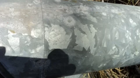

The galvanized piping that I am using came off a 1950's furnace that was in my home, that I am renovating. The galvanized piping I have, is thicker then what they sell at Lowes. Things that they built in the 50's, including cars were made of a thicker gauge metal.

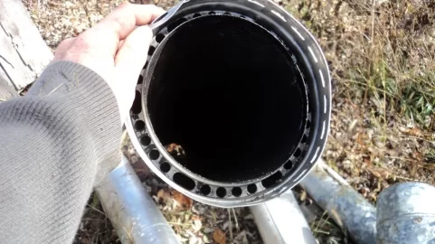

The newer flex piping that is in a fireplace that I am not using, is very thin flex pipe, that I suspect might be stainless steal? Which should I use and how can I tell if the thin flex pipe is stainless steal?

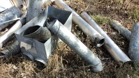

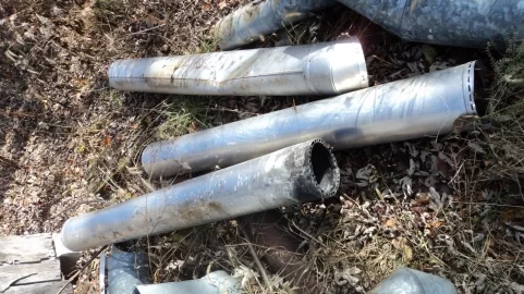

I would love to see photos of the galv pipe, side view, end view and any markings before advising.
[Hearth.com] Heathstone Heritage 8021 [Hearth.com] Heathstone Heritage 8021 [Hearth.com] Heathstone Heritage 8021 [Hearth.com] Heathstone Heritage 8021 [Hearth.com] Heathstone Heritage 8021 [Hearth.com] Heathstone Heritage 8021 [Hearth.com] Heathstone Heritage 8021 [Hearth.com] Heathstone Heritage 8021 [Hearth.com] Heathstone Heritage 8021 [Hearth.com] Heathstone Heritage 8021 [Hearth.com] Heathstone Heritage 8021 [Hearth.com] Heathstone Heritage 8021 [Hearth.com] Heathstone Heritage 8021 [Hearth.com] Heathstone Heritage 8021 [Hearth.com] Heathstone Heritage 8021 [Hearth.com] Heathstone Heritage 8021 [Hearth.com] Heathstone Heritage 8021 [Hearth.com] Heathstone Heritage 8021 [Hearth.com] Heathstone Heritage 8021 [Hearth.com] Heathstone Heritage 8021 [Hearth.com] Heathstone Heritage 8021 [Hearth.com] Heathstone Heritage 8021 [Hearth.com] Heathstone Heritage 8021 [Hearth.com] Heathstone Heritage 8021 [Hearth.com] Heathstone Heritage 8021 [Hearth.com] Heathstone Heritage 8021 [Hearth.com] Heathstone Heritage 8021 [Hearth.com] Heathstone Heritage 8021 [Hearth.com] Heathstone Heritage 8021 [Hearth.com] Heathstone Heritage 8021 [Hearth.com] Heathstone Heritage 8021

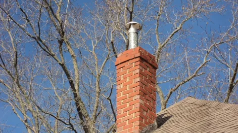

Oops, I must have clicked something wrong, because it doubled my pics? I have 3 pieces of double wrap, the pic with the garbage bag is the flex piping and the galvanized. I spent all day installing the galvanized and would like to keep it until next summer and probably install the double wrapped pipe or maybe the flex stainless? It was really hard to install the galvanized, took me all day and it's getting cold here at night.

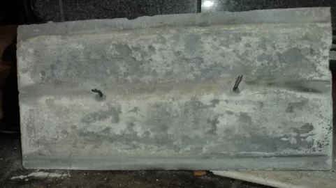

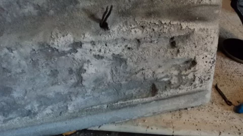

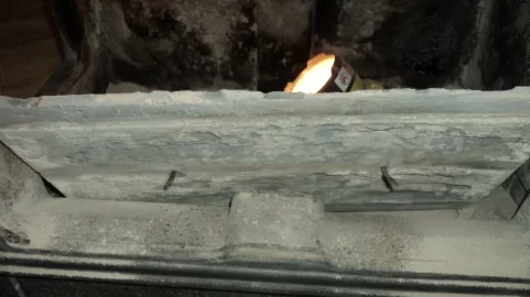

What do you think of the baffle? Does it look like it might get me through the winter or should I go ahead and replace it now?

Man, if that's not class A, I would wonder about the off gassing when that pipe gets hot, for one. I guess I'm going to say what you don't want to hear and suggest you don't use it until you can drop a proper liner down there. The baffle doesn't seem like an immediate issue from what I can see briefly in the photos. I'd rather see you take the baffle money and put it towards the chimney. So that liner is passing thru that galv pipe and the galv pipe is what is lining the total length of the masonry chimney? And the masonry chimney has a proper clay tile?
