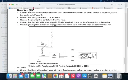

Yours looks to not have one. That rheostat box has a timer function built into it. I think it is 9 minutes. You have to make sure that is wired correctly. Let me see if I can find you a diagram for it. It is easier to show a diagram versus trying to explain.
