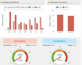

Here are some real numbers from my Venstar Thermostat. The high run times from last week was because I was away on vacation and we had record cold here.
I tune my own oil furnace so I know the exact firing rate/oil consumption per hour.
My furnace is a 2 year oil Carrier high efficiency forced air. House is 1800 sq ft from the 1960s and is insulated.
Furnace has a .68 nozzle so it burns .68 gallons per hour of run time.
I filled in late Jan for $1.29 a gallon
So far my monthly run times have been almost exactly at 75 hours.
.68 gallons/hr X 75 hours = 51 gallons X $1.29 = $65.79 montly oil cost.

$66/mo, wow that is cheap. We are running about $100 with full time pellet heat (propane back up) in Northern Mi.
Doom and gloom for pellet and stove sales until the next energy spike.
How many square feet?
Great that you can heat for so little this season!
