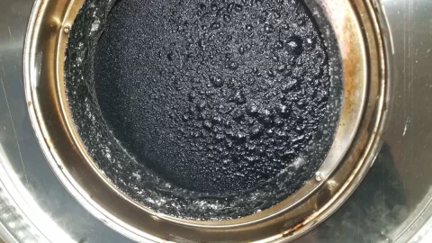

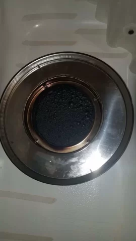

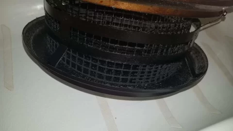

Hello everyone, this past weekend I got my new chimney installed and fired up the Grandpa Bear for the first time. From advise received here, it is a 7" duravent class A. It stands a 16', black 7" single wall inside with a 8-7 reducer at the stove outlet. I have been burning round the clock since 6 'o clock on Jan 30th. I was going to check it this Sat. but I was just coming back from the chicken coop this afternoon and happened to look up at the rain cap, not good. As luck would have it, I haven't added any wood to it today because I was going to clean it out the ashes this afternoon. I went up on the roof and got the rain cap off, it is a sticky mess. It's so bad that there are drips on my metal roof and drips on the pipe under the cap. According to the magnetic thermo I have on the stove pipe, it runs around 300 to 400. The wood being burned is red oak, holly, white oak, and cherry blossom. According to the moisture meter it is all between 18 and 25%. Can someone tell me what is going wrong here?

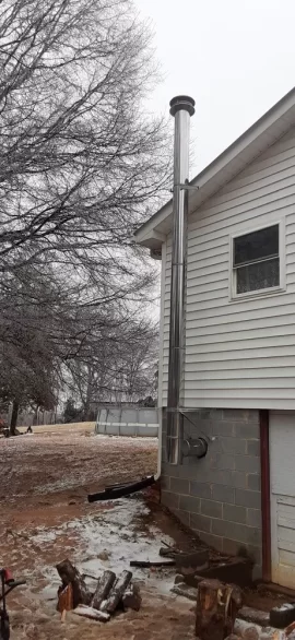

This is what'a going on. I have another 4' section of chimney pipe, but did not install as I measured and met the 10/2 rule.

If you started burning on January 30 and on February 3 you have this amount of creosote, even at the top of your chimney, something is wrong.

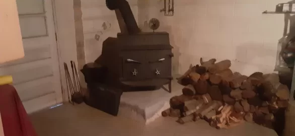

You are burning wood that is to wet in an old steel box stove with no secondary combustion system at all creosote buildup is a given.
If wet wood is to blame, that's an easy fix. I'm really hoping something is not wrong with my setup. I am going to be installing a baffle plate in Grandpa. The draft on the chimney is very good, I have not had any issue at all with smoke coming back in with the doors open, but is 16" enough? The smoke seems to want to follow my roof and come down toward the ground.

With dry wood it will certainly be better but with that stove you are always going to have creosote buildup a baffle will probably make it worse
