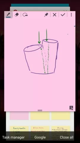

Okay..a little rough...but...Im so much better at showing people what I mean.
This was screen shot from my Note 3 phone.
This is how I salvage crotch wood by splitting off as much as the straight stuff as possible. This requires hydraulics. Your first 2 splits as close to the V as possible.

Now I would split this 90* to what your drawing shows,right down the middle most times it will
split right down splitting both in half. We call these pant legs don't seem like it would work well
but dozes try it I think you will like it.

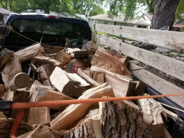

I split Ys by hand, so I can't split really big ones. I split from the side, so I am splitting both branches of the Y, and I end up with two Ys, each with one flat side.
[Hearth.com] Hefty Y sections

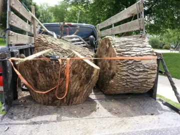

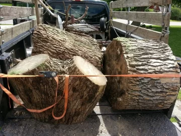

I turned this CL score into this today. A pain to split and stack, but great wood. The one in the back was a fork as well.
[Hearth.com] Hefty Y sections [Hearth.com] Hefty Y sections
