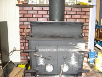

Hi everyone, i've been reading posts for a few days now, It's kind of an info overload. I live in a '30s bungalow 1000sf. Insulation in the attic and under the floor but none in the walls. Windows are old double casement with storm windows. I have a Whitfield profile 20 in the dining room and a schrader woodstove in the living room. I'm thinking about replacing the schrader with something newer. It's a beast. 36" high 28" wide and 24" deep. Firebox is about 3 cu. Has double doors with a damper knob on each door. No glass. I want a stove that will burn thru the night and has a glass door. My Whitfield pellet has a hard time keeping this old house warm unless I run it 24/7. Pellets were $200 a ton last year, Firewood split and delivered is $168 a cord for fir and $188 a cord for soft maple. Is it worth it to get a more modern stove or spend the money on more cords? thanks oregonrider

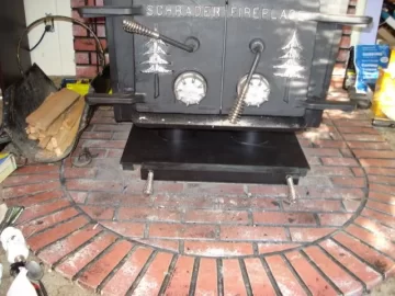

Hi Kevin, I'm 45mi. east of eugene up the mckenzie river valley 6 mi. west of blue river. My hearth is brick 1 3/8" thick it's 60" wide 64" deep with a semi circle front edge 48" up the wall behind the stove.it's 21" from the back of the stove to the face of the brick wall.Stove pipe is 8" dia. up to the ceiling where it enters a square box 14" on a side. Out of the roof the OD is about 11" with an 8" ID. Living room is 13'x25'. With1/2 the ceiling vaulted, big ceiling fan for each side. I use the pellet stove to maintain a tollerable Temp, the thermistat is set for a low of 65 at night 60 during the day with it set to come up to 70 in the morning about 2 hours before I get up , lower down when I leave for work then bring the temp up to 72 a couple hours before I get home from work.It has to work pretty hard to do that and because it"s in the dining room, the living room stays in the 60s. I usually start a fire in the wood stove when I get home from work and on the weekends. last winter I used 2 tons of pellets and almost 2 cords of firewood. I would say the stove, hearth and pipe probably met code when it was installed in the late 70s or early 80s. That was when Schrader was in bisness. Stove is 1/2 down insde wall of living room. Opening between living and dining room is 48"x80". I'd like to use the wood stove more as my primary heat but this one won't keep a fire all night or when I'm gone during the day. I work in eugene and live alone so I'm gone 10 or 11 hours week days. I installed the pellet stove when I bought the house 3 1/2 years ago. roben.

how do I attach photos?
  • [Hearth.com] Hello! New to site.
