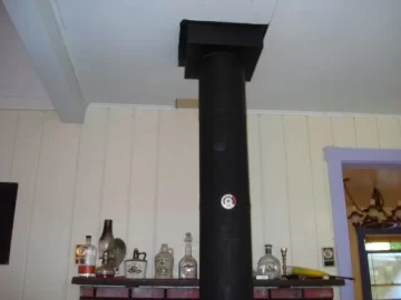

Hi Mike *" pipe enters box then is approx. 11" outer pipe up thru roof 8" pippe is of course continuos inside
just saw the pictures , wowo that schrader looks like it was a "stud" in its day looks like you would need a 6 to 8 increaser above the stove to connect to the 8 inch flue. should be able to do that between the stove and the ceiling , i would probably do it just below the ceiling as it would look better. the stove can be run in an 8 inch round without any problem especially since its an interior chimney
Hi Mike, as far as running a borebrush down it for cleaning would I be better off running a a 6" pipe all the way up? Or just disconnect at the 6 to 8 to clean? roben.

In terms of cleaning, yes going to 6" all the way would probably be easiest to clean, but doing a 6-8 transition and having to separate the pipes wouldn't be totally horrible.
Your hearth looks pretty good in the pictures, it should meet current codes for almost anything in terms of area, however I'd be a little bit worried about what is under the bricks - Depending on the R-value requirements of the stove, just a layer of bricks over a wooden subfloor might not be enough, however if there is a layer or two of cement board then you should be golden for most stoves.

Hi begreen and gooserider, I'd really hate to bore holes in my shiplap interior walls or the clapboard exterior. The hearth seems to set on linoleum which covers the fir flooring. How do I check the R value of a new stove?
No problem, I have a clapboard (bevel cedar siding) and had to patch the exterior holes. Once they are plugged and sealed (I used bondo) and sanded, they paint over and disappear.
For hearth requirements, download the manual for the stove of your choice from their website and go over the installation details. Some stoves have pretty light needs, basically a non-combustible barrier and others have serious insulation requirements. Depends on the stove. The Quad is low, the Englander requires a bit more (R 1.5), but not high. For the Englander go to: http://www.englanderstoves.com/manuals/30-NC.pdf

webmaster, I looked at some of these online manuals, thanks for the heads up. That lead me to another question. They say a class A stove pipe is required. how do I determine if what I have is class A or not? roben.
Class "A" is what is needed for a prefab chimney from at least the first wall or ceiling penetration to the top of the stack - You can bring the Class "A" all the way to the stove, but it isn't really necessary. From the stove to where you connect to the Class "A" can be done with your choice of a couple different (less expensive) sorts of "connector pipe" If your existing stove was installed per code, it probably already is Class A - check to see if there are any labels on it or stamped info on the pipe that would help identify it - ideally brand and model numbers... If it is not Class "A" then you would need to replace the existing install or another alternative MIGHT be to drop an insulated 6" liner down your existing 8" pipe, however I'm not sure how that would work for termination top and bottom.
Essentially since we can't see exactly just what you have, what you may need is an inspection by a good sweep who can tell you exactly what you already have to start with, what kind of shape it's in, and any possible issues - we can then give you a better idea about what to do concerning them.
