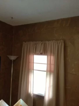

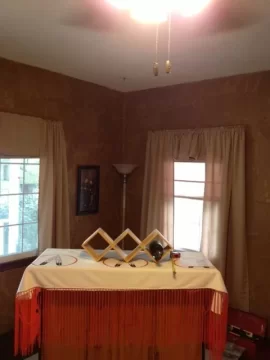

This is the location. We want to put the smoke pipe through the wall above the window on right side, as there isn't much room on the outside of the house. The bar you see is where the burner will sit. Our specs from the insurance company say the 3 feet rule, plus the pipe needs an 18" from combustibles...will a through the wall kit take care of that, or will we need to modify the wall and ceiling around the pipe?
That is not a good location for a number of reasons. Single wall pipe will require 18" clearance to walls and ceiling. Double wall will require 9" clear to the ceiling. There will be a header above the window and cripples. Finding a right location there will be hard. Also, curtains will have to go or be over 36" away from the stove. If this is the only location the stove will need to be deep into the room. A close clearance stove would be safer here. Can you go straight up with the pipe instead of out and up?
Yeah, we figured as much. We've decided to put off until next Spring, hire a contractor, take out the double window to the left, put the single window on the right in it's place. That will leave the entire right wall to play with, and give us more room on the left as well. Really wanted to have a fire this winter, but just not in the cards this year.
Thanks everyone for your help with this!
Sounds good if there is no option to go straight up.
