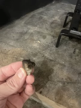

I've owned my current home for (4) years and had the fireplace cleaned last year. The home was built in 1987 and I believe this is all original. I've yet to use the fireplace. Recently, while installing a chain screen some of the mortar or cement fell out between the exterior brick veneer and the steel firebox. What would a professional use to fix this? Should I chip it all away and replace the the entire joint?? Thanks in advance!

Personally I would scrape all the loose stuff out, and then pack it as best as possible with mortar mix.
Any mortar will do but it will crack eventually, just too much difference in expansion and contraction. I typically use chambertech because it is a bit more flexible and resistant to cracking
I would prefer to use the chambertech, but I'm only seeing $100+ larger containers. Would this work? It's premixed, so one less thing for me to goof on. Says it bonds to masonry and metal.
Just use regular mortar. Furnace cement is extremely brittle
