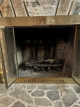

Hey all,
Just moved into my new house located in Sandy Hook CT, USA.
I would like to put either a free standing wood stove, or a wood stove insert (with blower) in.
It is an 1,900 square foot home - we have an additional wood stove up in our bedroom. According to the previous homeowner, the upstairs wood stove heats the entire upstairs.
I need help deciding on a stove for the fireplace. It is not currently lined for a stove (I will do that with a friend most likely).
I stopped by a local stove shop and they pushed me towards an insert and went into detail on how inefficient they are , especially when they have to sit back in the firebox.
I took a few measurements, it is 29w x 41h. The firebox to the end of the hearth is 19 inches.

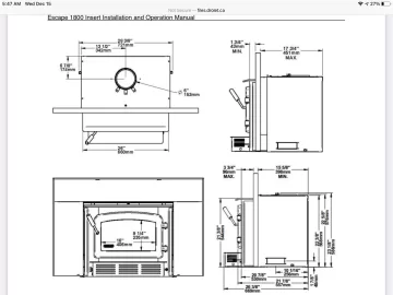

Alright, going to pull the trigger on this Drolet soon. Just took dimensions again realized I miswrote them..
It is 40w x 29h and 20 deep (it bows towards the top so at the most shallow part it was 20 inches).
Length and width I know it will fit , just wanted to make sure the depth would fit. The total depth appears to be 26 3/8. If my depth is only 20, is this stove too big to fit? I know the front sticks out, just not sure how much...
Thanks!
Which Drolet
Alright, I think I figured it out. At where the height where the stovetop would be, it sticks about 3.5 inches onto the hearth. That seems to be enough clearance. I didn't think about how the height of the stove wouldn't come to where the chimney is the most shallow depth wise. My hearth sticks out about 19 inches so if it spills out some, I will be okay.
Thanks!
Thanks!
By design it sticks out some. You have 2” front to back adjustment with the surround.
