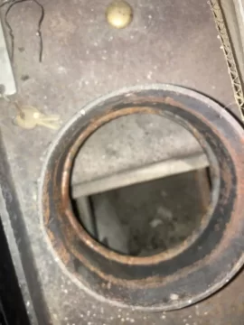

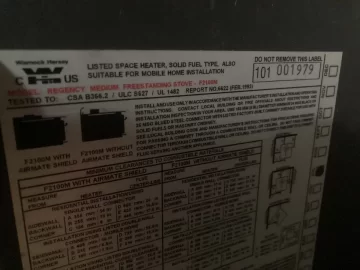

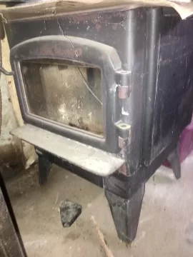

In order to judge its value, we need to know more about the used woodstove's condition and its installation requirements. Can you post some pictures of it showing the exterior of the stove and the interior of the firebox?
here are some pics: We are hoping it’s mostly surface rust from being stored in a basement and can be sanded off without problems. It’s a Regency stove… one crack in glass. Sorry for bad pics but it is in storage and has cobwebs too!
[Hearth.com] Help deciding please![Hearth.com] Help deciding please![Hearth.com] Help deciding please!
That's an F2100M. It's a medium-sized stove with a 6" flue collar. If it is in good working condition, then with a clean-up, new glass, gaskets, and fresh paint it could be a good stove. The DIY requirements will depend on the house setup, but it can be done.
